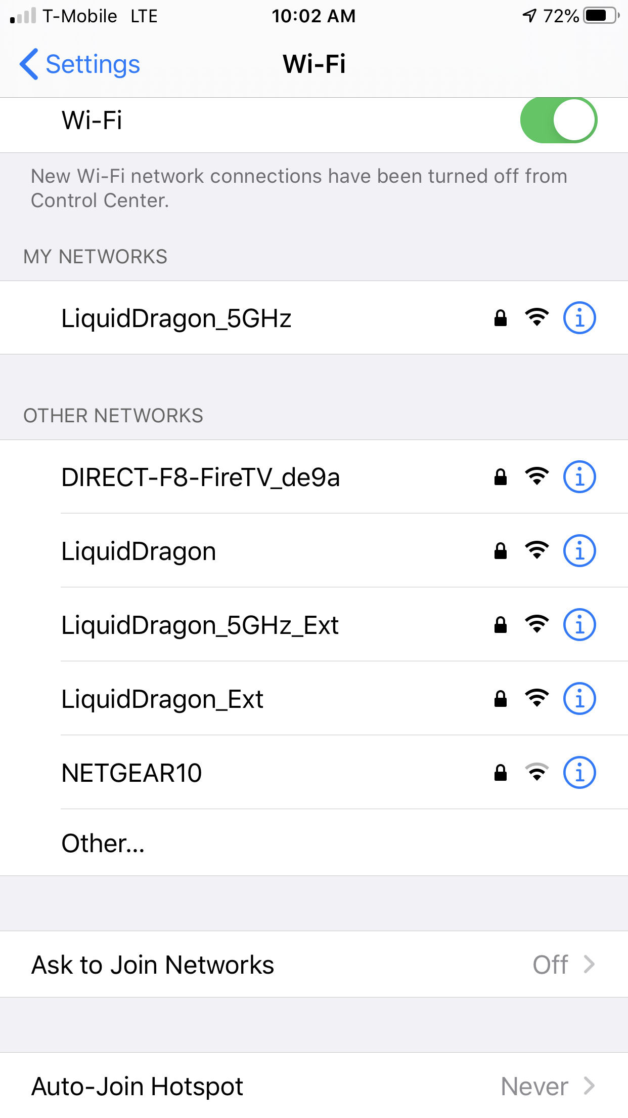

I have answered your question about my Wi-Fi setup which I posted above. I have a Linksys WRT1900AC router and I just added a Linksys RE6300 range extender yesterday. My router is in the middle of my house (single story 1800sqft) about 32-35ft away from my Sense monitor so it is well within the acceptable distance for the 2.4GHz band. With a direct line of sight there are two walls between my router and the Sense monitor but nothing significant that could cause that much interference to effect the Wi-Fi signal.
If you read my comments and my question about my plugs you would know that even though Sense says I’m at 33 plugs it sees these 33 plugs as only 18 plugs because I have 3 HS300’s which account for 18 of those plugs and is only seen as 3 plugs by Sense. There is approximately 40ft between my house and my neighbors house’s on either side of me and approximately 80ft to my closest neighbor behind me and approximately 200ft to my closest neighbor across the street from me.
Again I have answered your question about my router and the pictures below should answer your other questions.
I have completely ruled out the issue being my network and my network wouldn’t have anything to do with the issues I am having in the app. I removed all integration from Sense last night and this morning one of my TP-Link plugs started showing up under my devices so again this isn’t a network issue on my end its an issue with Sense and more than likely an issue on the Sense server where all the data is managed is probably part of the API issue.
Oh and all the LiquidDragon networks are mine and obviously the one’s with Ext at the end are the range extender and the fireTV is mine as well and the only one that isnt is the NETGEAR10 which is my closest neighbors wifi.
