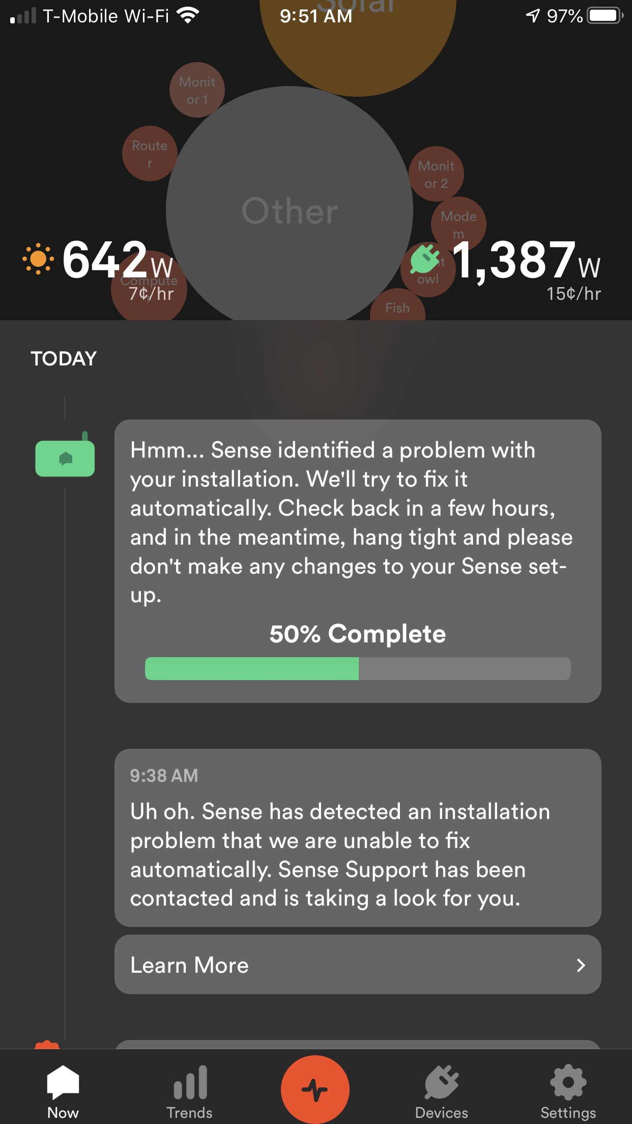

Right now I have continued to work on my Sense monitor. I opened my power panel this morning and figured out that one of my mains CT clamps was on backwards so I removed it and placed it on the main line correctly. I remember that when I first installed my sense meter this issue was discovered during setup and my Sense monitor was able to fix the issue electronically instead of making me physically fix it but this time it seems my Sense monitor was unable to do this. My mains readings are looking good so far and I am waiting for my signal checks to complete before I move forward with turning on my solar and reattaching the solar CT clamps back into the Sense monitor. I was also able to turn on network listening and smart plug integration with positive results again and I have gone through all my smart plugs and disabled control and turned off showing them on the timeline until I figure out which ones I want to see.
