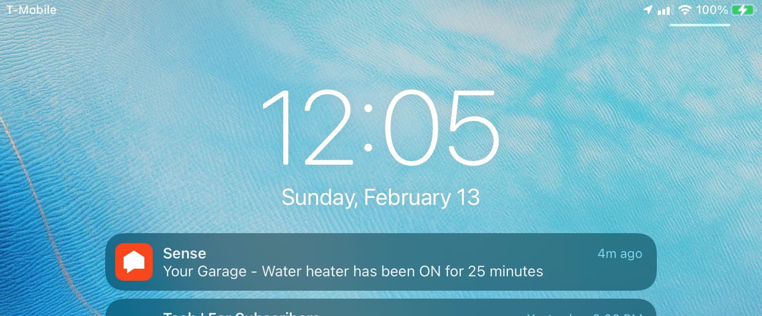

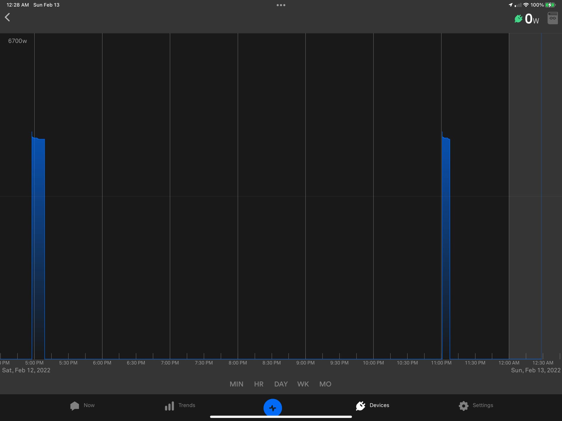

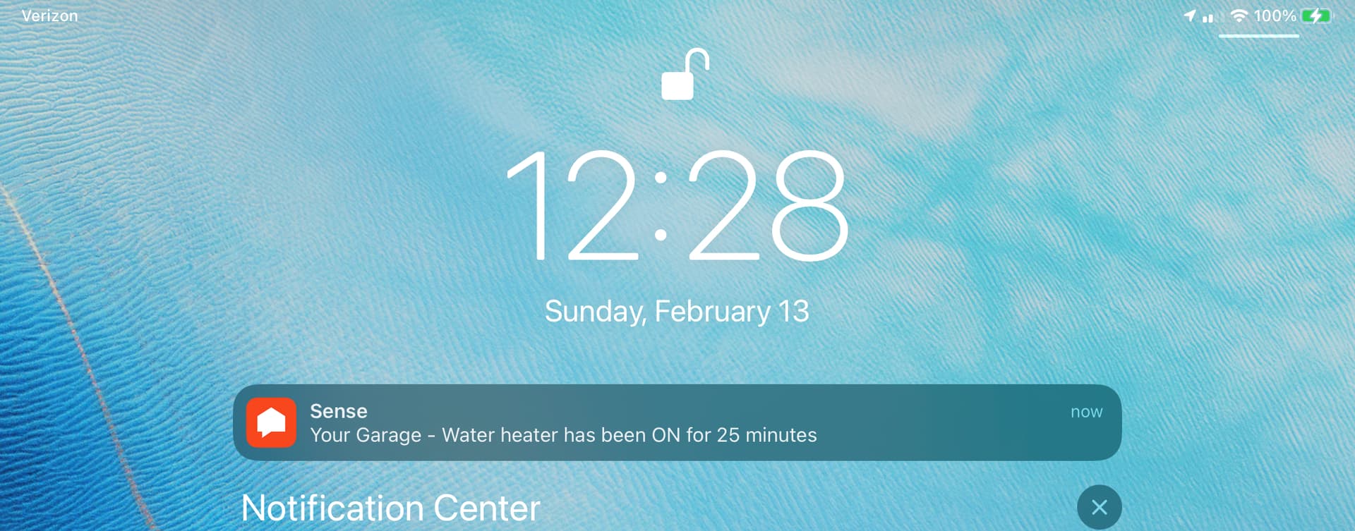

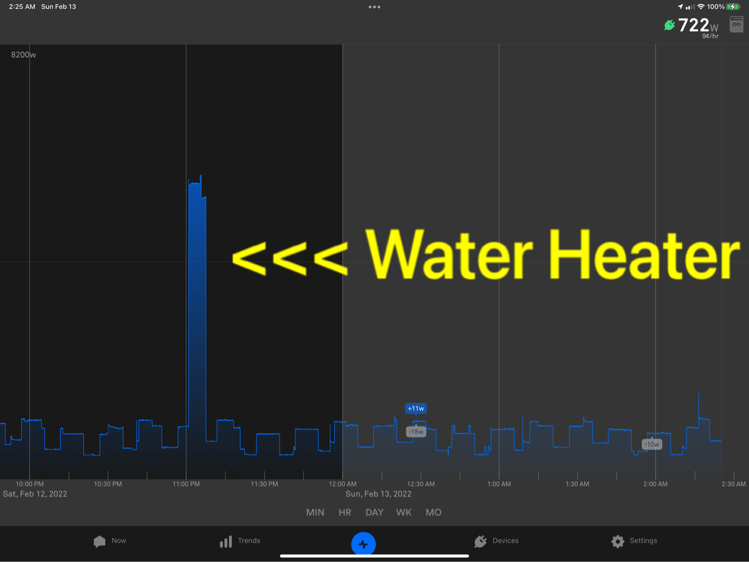

As you can see my Water Heater was on from 11:01P until 11:08P
Yet this notification at 12:01AM states my Water Heater has been on for 25 minutes, meaning it turned on at 11:36PM and then turned off in the subsequent 25 minutes which was missed based on your hypothesis.
Didn’t happen

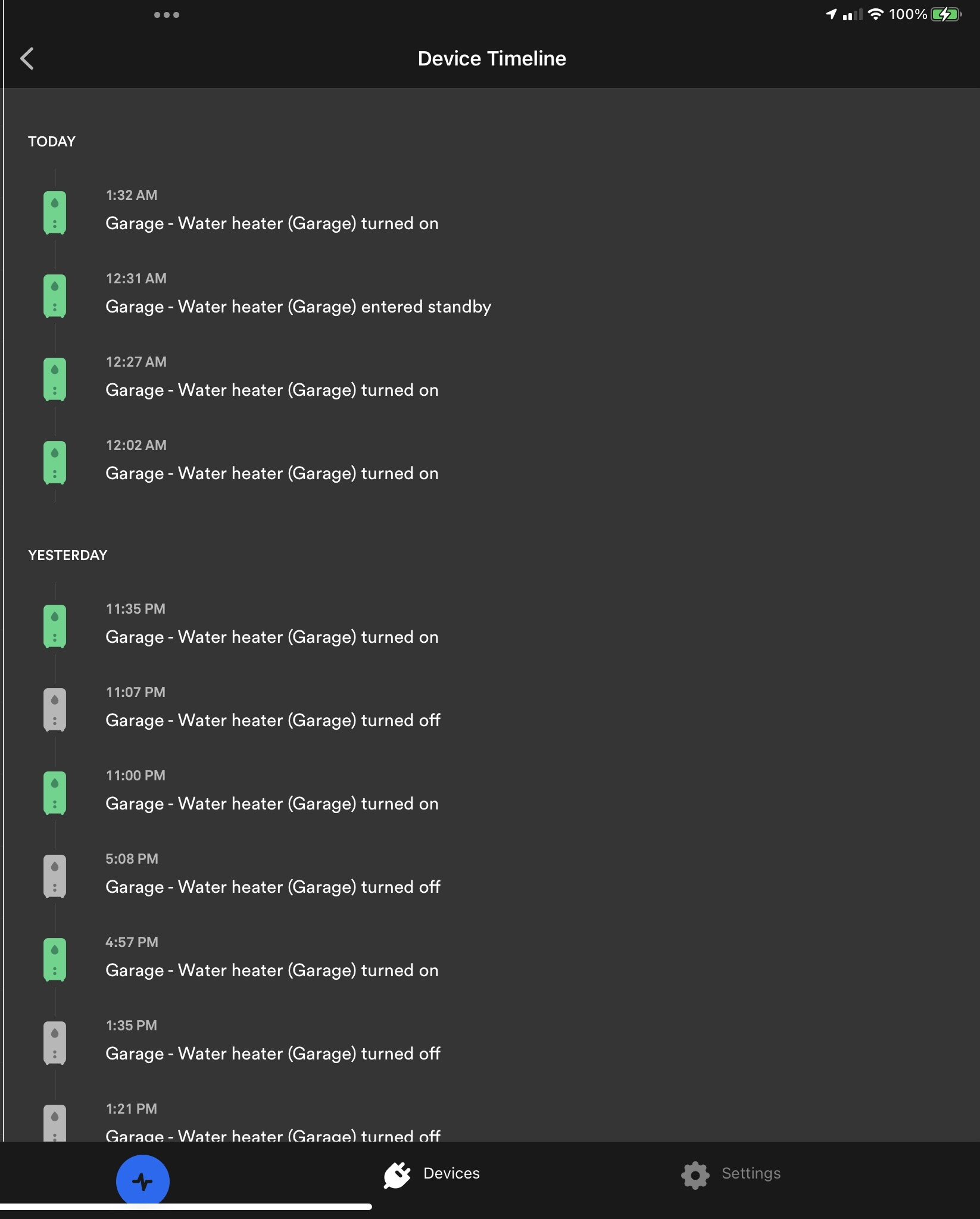

And now it’s infiltrating my Device showing incorrect info.
Notice all the “offs” disappeared after 11:07PM, not that it was ever really on to begin with.

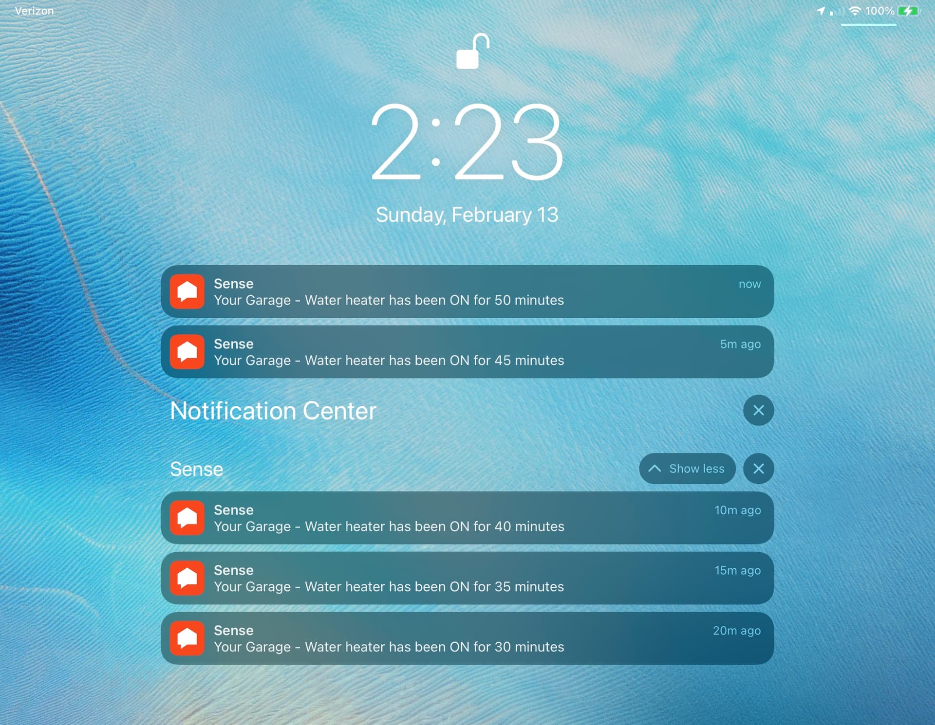

I just received notification my Air Hander has been on for 60 minutes.
It would have had to miss 3 ons and offs for this to happen.
Between the multiple similar instances, it’s more likely that I am receiving someone else’s alert instead of missing 3 off and on cycles this time (a swell as the others).

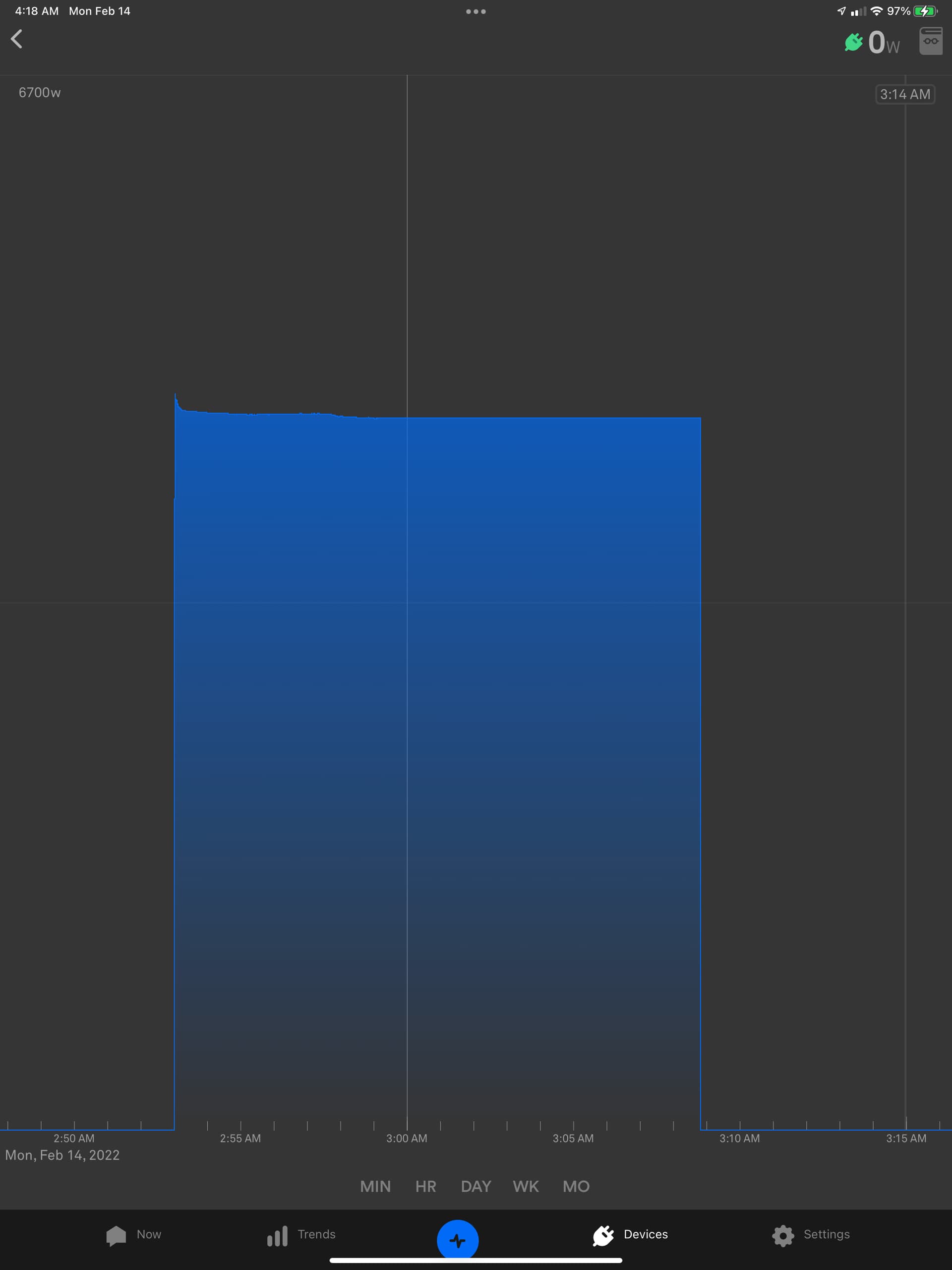

Clearly someone else’s Water Heater
For my water heater to be on for 1 hour at 4:09AM, it would have needed to turn ON at 3:09AM
Maybe coincidental but it seems notable in this case that your water heater switched OFF around 3:09 at the time when, if the notification were correct, Sense starting clocking “a water heater” going ON.
