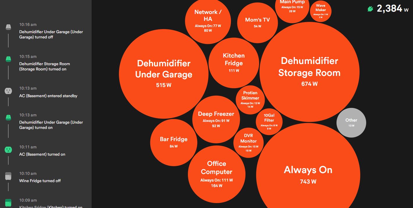

edit OK, once again the online and offline models are not matching up. Bubbles staying on (both web and mobile) while timeline shows they turned off (I confirmed they turned off).
additional
Kitchen fridge turned on (shows in timeline) @ 9:01 but no bubble.
Dehumidifier (storage room) turned off at 8:57 (timeline), bubble remains.
Wine fridge on 9:05 (timeline) no bubble appeared, off at 9:09 timeline.
update Things are all out of wack. 9:19 kitchen fridge bubble just appeared and dehumidifier bubble went away.
Dehumidifier (under garage) Now timeline shows turned on at 9:28 (no bubble), devices timeline last state shows off at 9:19.

Current screenshots
Note: Dehumidifier under garage timeline & bubble vs. device timeline.
Desktop:
Cell:
I have 2 different dehumidifiers, different models that do not interfere with each other (think they are on different legs too). As stated this is happening with other devices as well, but not all. All Kasa devices appear to be displaying accurately.

Does appear as if it’s an issue between the two models.
No bubble for dehumidifier storage room
No bubble for Wine Fridge
I had some issues in the past before I did complete reset but never this bad. The explanation then was one of the models (Sense uses two and online and offline version) missed an on/off signature. But this seems a bit different almost as if something is going on with the “online model” on the backend.
I did make the changes noted in the 1st post, no idea if one or a combination of those things may have caused a glitch in the system, but I do feel that it’s not a simple coincidence.
I really have no idea, as none of us know how the backend systems work exactly, but the little insight I was given it does seem logical that the online model is having a hard time processing some of the information, almost as if it’s lagging with some devices. Which if I understand correctly could cause detections to show in one place but not the other.
